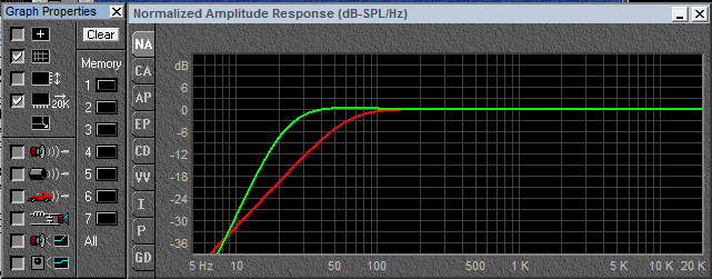

Update.. after much sawing, drilling and gluing, the first boxes are now made, and fit well. They are the 2 sealed enclosures for the 2 JL8w3's which sit in the bulkhead behind the driver and passenger seats, firing forward (same setup as MR2). Took much longer to measure up and design than to build and fit. Will take some pics tomorrow when the glue is dry and the boxes are finish sanded. They will run midbass down to around 80-70Hz then filter out and let the 12 take on the real lows with its own amp. The 8's are the red line on the graph below (bass box pro), the ported 12 is the green line which has a F3 of 26Hz, so should go real low! What i tried to achieve here is midbass that will hit really hard, and low end bass that can get down low. You usually only get one or the other but hopefully i should have both, thats the plan anyhow.
