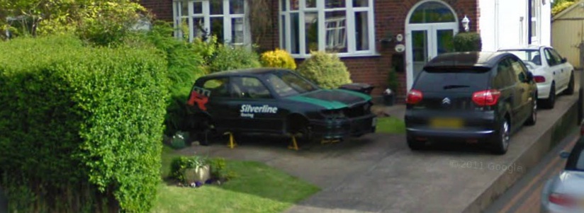

But at the same time a very good item came up for sale.
A mint shell :)
The Below was taken from the advert for the shell
The shell has every single whiteline option including all bush options/both ARB's/Anti dive kit/NEW bump steer kit/New powder coated front wish bones with new ball joints/Nismo KYB susp/2 new chassis rails/rust treated and painted underside/poly gear linkage bushes/poly steering rack bushes/new power steering pipe work/new brake lines/all non load nuts and bolts have been replaced with stainless/Walbro fuel pump and all other bolts holes and bolts/nuts have been re tapped and copper slipped for ease of dis assembly .
Oh and it's been re painted Ferrari Metallic Nero, I just had the one of the front wings and front bumper re done
Most of the whinline kit was removed before sale, buts everything else inside and out was good and only needed a few things to be looked at to get it 100% tho.
These pics are from the previous owner..
